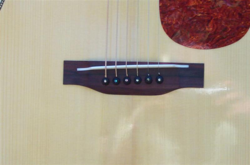

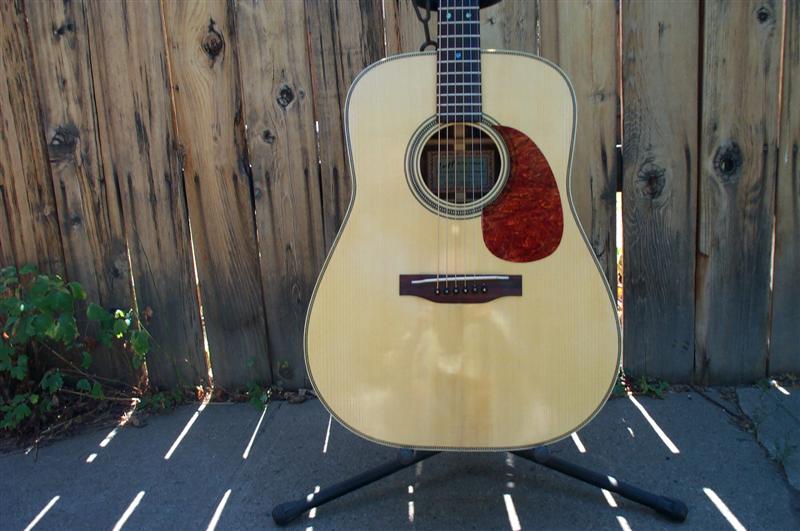

Well, almost... Still need to tweak the setup a bit.
EIR back and sides
Carpathian top
Hondo Mahogany neck
Bois D' Rose fretboard and bridge
FP finish
Still not staisfied with the finish, but it's better than #1. There's a few other warts, but even with the strings on it for only a couple of days, it already sounds better than my Collings!
-Mark

PostPosted: Sat Sep 02, 2006 8:33 am
Very nice for a number 2!! I would have guessed number 8!
The setup looks pretty good from here!

Pat - I built from both the Stewmac and LMI (Antes) plans. Used the Stewmac plans for templates, and tweaked them a little according to measurements on the Antes version.
I think one of the reasons it sounds so good is the Carpathian top. Plus, I was careful to shift the X-brace forward, and was pretty liberal with the scalloping. No popcicle brace either, which I think helps a lot...
-Mark

How far forward did you move the X Brace and what is your top thickness ?
Nice neat work . Congrats.

Wow! Thanks for all the kind words!
Craig: The X-brace is 9 1/8 in. from the 14th fret, and the top is about .098 in thick. The Carp top was VERY stiff. I should mention also, that I had some fibers pull up from the binding tape (wasn't paying attention!), and had to sand a bit of the top away at the edges. Perhaps that was a "happy accident".
The real test will be when I take it to my next lesson with John Lowell. John has two Proulx dreads, so it will be interesting to compare!
-Mark

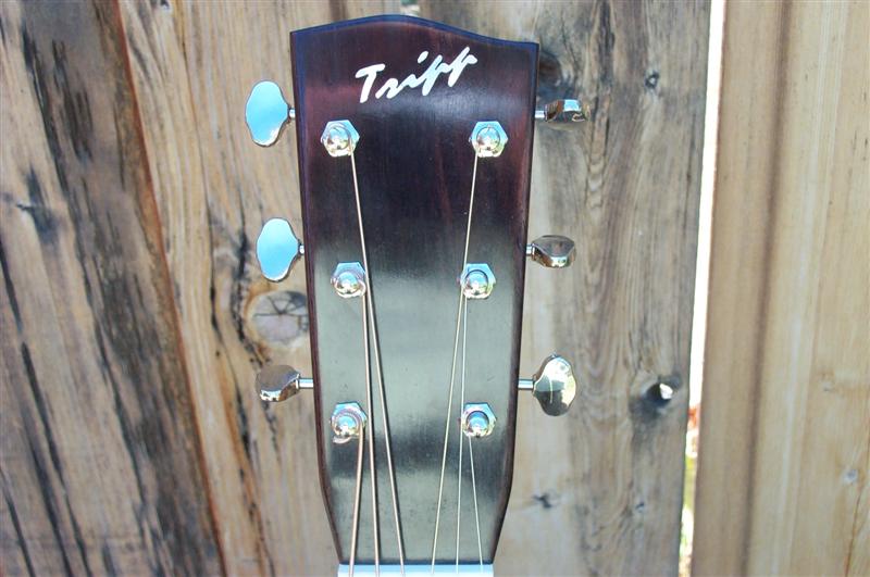

Very nicely done, Mark, I like the shape of the headstock.

I love your headstock inlay... Very, pardon the pun, 'trippy'!

Hey bud, you stole my headstock shape that i have stolen from someone else's!
Yup, love your logo too!
